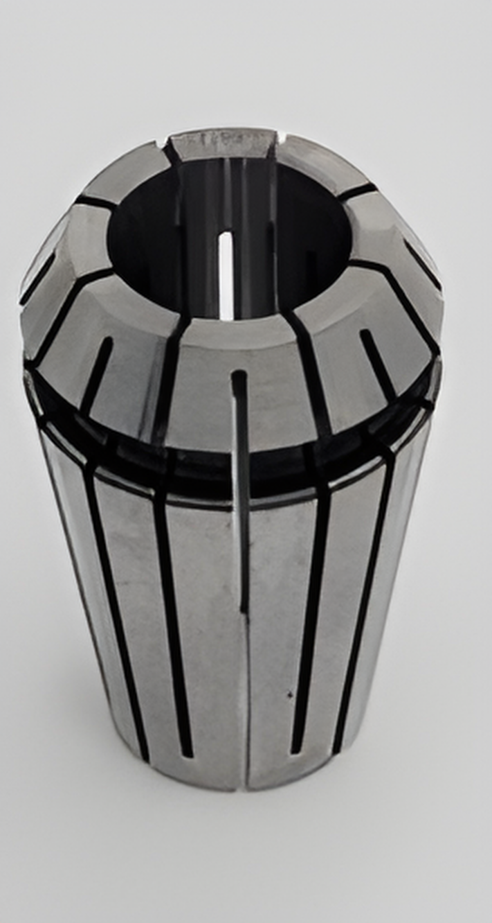

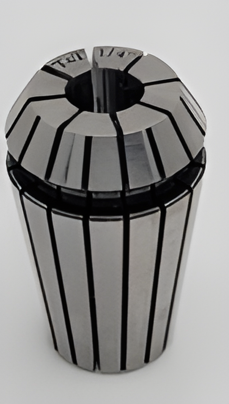

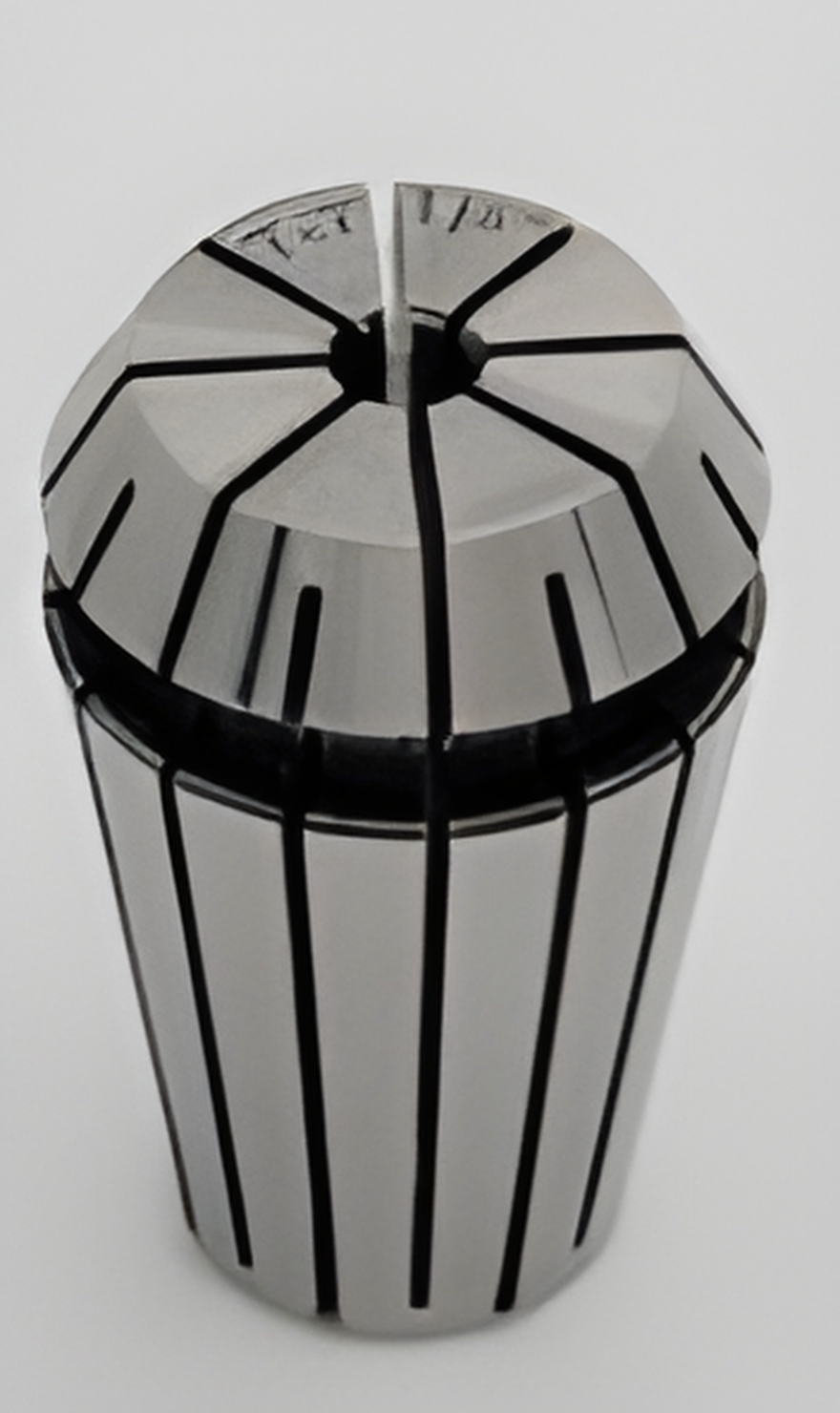

ER-16 precision-grade (PG) collet
- Architecture: interleaved spring collet
- Steel : SCM440
- Hardness: HRC 46
- Taper: 8°
- Surface Roughness: Rz 2.5
- Internal hole by boring machine
- Compatible with DR, RD, ESX, AR, & BR Series Collets

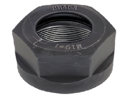

These collets and collet nut are for the X-Carve PRO spindle.
(They are not compatible with the DeWalt or Makita routers for the X-Carve 1000mm Belt Driven Kits.)
- 30895-01: 1/8 in. (0.1250") clamping ER-16 precision-grade (PG) collet
- 30895-02: 1/4 in. (0.2500") clamping ER-16 precision-grade (PG) collet
- 30895-03: 3/8 in. (0.3750") clamping ER-16 precision-grade (PG) collet
