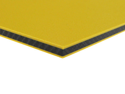

This King ColorCore® unique 3 layer high-density polyethylene sheet is perfect for engraving. A layer of black HDPE is sandwiched between two 0.050″ layers of yellow, making it easy to expose different colors while engraving or milling.
This material is strong and environmentally stabilized, meaning it can withstand harsh weather conditions. This makes it great for sign-making, marine applications, recreational equipment, etc.
