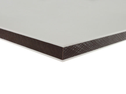

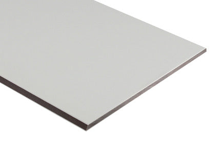

This King ColorCore® unique 3 layer high-density polyethylene sheet is perfect for engraving. A layer of brown HDPE is sandwiched between two 0.050″ layers of white, making it easy to expose different colors while engraving or milling.
This material is strong and environmentally stabilized, meaning it can withstand harsh weather conditions. This makes it great for sign-making, marine applications, recreational equipment, etc.
The sheets are masked on one side. The other side may have minor scratches or scuffs.
Top and Bottom Layer Thickness – 0.050"
