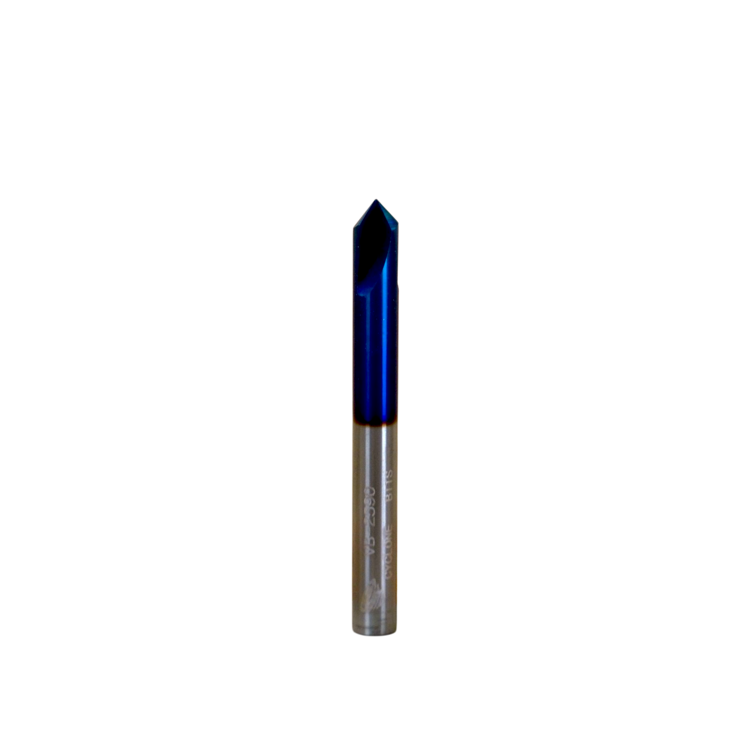

90° V-Bit
Overview
Built for bold engraving, chamfering, and decorative bevels. The 90° angle creates wider cuts than sharper V-bits, making it ideal for readable text, sign work, and edge detailing. Nano Blue coating helps improve heat resistance and tool life on spindle-driven CNC machines.
Best For
  • Bold V-carved lettering
  • Chamfers and edge breaking
  • Decorative bevels
  • General sign work
Why Choose It
  • Wide angle for bold, readable cuts
  • Great for chamfers and edge detail
  • Clean cutting with good chip evacuation
  • Versatile general-purpose V-bit
Starting Parameters
Conservative starting values. Adjust for material, machine rigidity, and cut depth.
  • Spindle: 14,000–20,000 RPM
  • Feed: 80–180 IPM
  • Plunge: 30–60 IPM
  • Depth Strategy: Reduce depth per pass in harder materials or longer jobs
Compatible Materials
  • Hardwood
  • Softwood
  • MDF
  • Plywood
  • Plastics
Specifications
  • Tool Type: V-Bit
  • Included Angle: 90°
  • Flutes: 3
  • Shank Diameter: 1/4"
  • Overall Length: 2.36"
  • Material: Tungsten Carbide
  • Coating: Nano Blue
Notes
  • Cutting width increases quickly with depth
  • Ideal for chamfers, V-carving, and bold lettering
  • Not intended for deep pocketing
