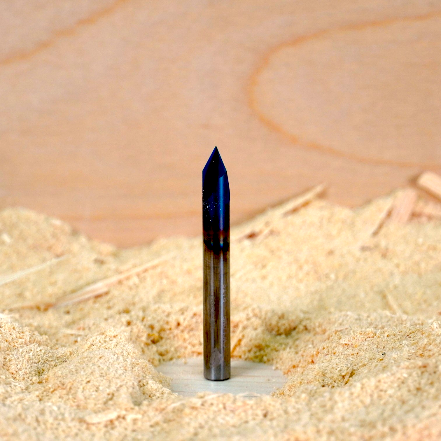

60° V-Bit
Overview
Built for engraving, lettering, chamfers, and decorative detail work. The 60° geometry offers a strong balance of edge durability and fine detail, while the Nano Blue coating improves heat resistance and tool life during high-speed CNC cutting.
Best For
  • V-carved text and graphics
  • Chamfering edges
  • Decorative detailing
  • Sign making and inlays
Why Choose It
  • Stronger edge than sharper V-bits
  • Cleaner medium-detail results than wider angles
  • Helps reduce tip wear on long engraving jobs
Starting Parameters
Conservative starting values. Adjust for material, machine rigidity, and toolpath strategy.
  • Spindle: 16,000–20,000 RPM
  • Feed: 80–160 IPM
  • Plunge: 30–60 IPM
  • Depth Strategy: Use shallow passes for consistent line width and finish
Compatible Materials
  • Hardwood and softwood
  • Plywood and MDF
  • Plastics and acrylic
  • Foam and composites
Specifications
  • Tool Type: V-Bit
  • Included Angle: 60°
  • Flutes: 3
  • Overall Length: 2.36"
  • Shank Diameter: 1/4"
  • Material: Tungsten Carbide
  • Coating: Nano Blue
Notes
  • Line width is controlled by depth of cut
  • Best results come from rigid machines and accurate Z-zeroing
  • Zero Z carefully to avoid over-cutting
