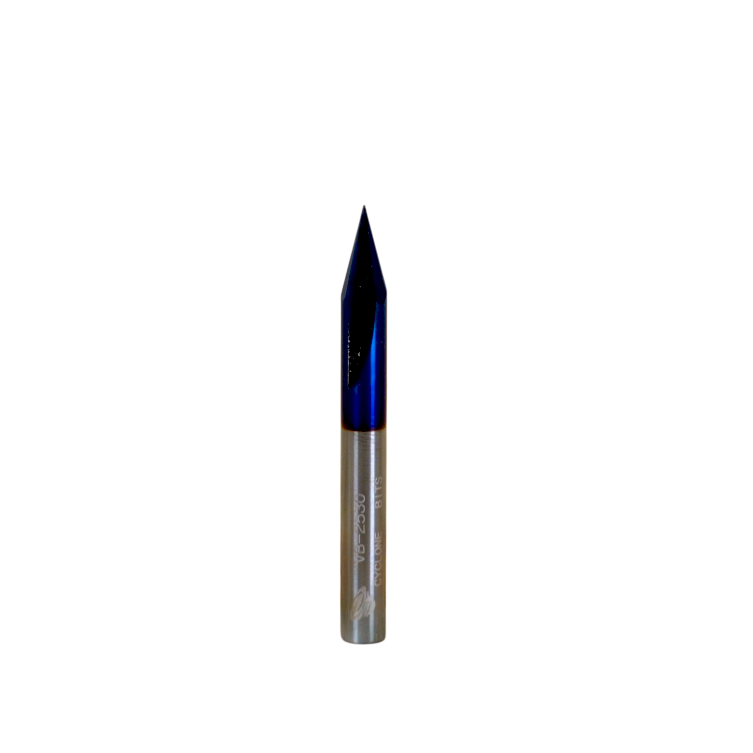

Built for fine-detail engraving, sharp line work, and precision V-carving. The 30° angle creates crisp, narrow cuts for text, logos, inlays, and decorative details, while the rigid carbide construction supports clean cutting on spindle-driven CNC machines.
Best For
  • Fine-detail engraving
  • Sharp V-carved text
  • Logos and inlays
  • Decorative line work
Why Choose It
  • Sharp angle for crisp, narrow cuts
  • Excellent control for shallow engraving
  • Clean edges with minimal fuzzing
  • Ideal for precision detail work
Starting Parameters
Light passes produce the best results. Adjust for material, machine rigidity, and detail level.
  • Spindle: 16,000–22,000 RPM
  • Feed: 60–140 IPM
  • Plunge: 20–40 IPM
  • Depth Strategy: Reduce feed and depth for very fine text or delicate materials
Compatible Materials
  • Hardwood
  • Softwood
  • MDF
  • Plywood
  • Plastics for engraving and marking
Specifications
  • Tool Type: V-Bit
  • Included Angle: 30°
  • Flutes: 3
  • Shank Diameter: 1/4"
  • Overall Length: 2.36"
  • Material: Tungsten Carbide
  • Coating: Nano Blue
Notes
  • Cutting width changes with depth of cut
  • Shallow passes produce the sharpest results
  • Not intended for deep material removal
