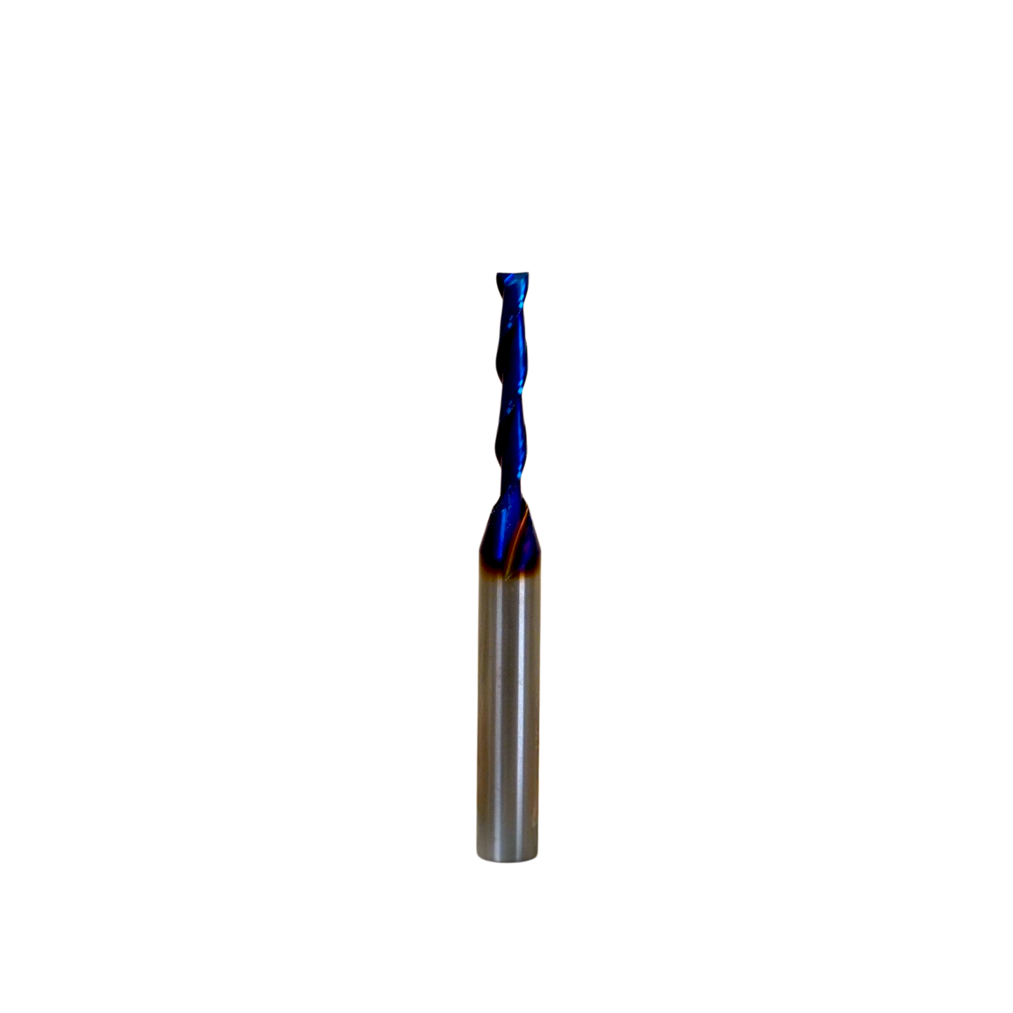

Built for efficient chip evacuation and clean bottom-edge finishes in pockets, slots, and deeper cuts. The up-cut geometry pulls chips up and out of the cut to help reduce heat buildup, while the rigid 1/4" shank improves stability on spindle-driven CNC machines.
Best For
  • Pocketing
  • Slotting
  • Deeper cuts
  • Efficient material clearing
Why Choose It
  • Strong chip evacuation for deeper cuts
  • Clean bottom surfaces in pockets and slots
  • Helps reduce heat vs. down-cut tools
  • Rigid shank improves stability and accuracy
Starting Parameters
Small-diameter tools work best with higher RPM and controlled feed rates.
  • Spindle: 18,000–24,000 RPM
  • Feed: 100–180 IPM
  • Plunge: 30–60 IPM
  • Cut Strategy: Use shallow stepdowns and avoid overloading the tool
Compatible Materials
  • Hardwood
  • Softwood
  • MDF
  • Plastics
  • Aluminum with light passes and good chip clearing
Specifications
  • Tool Type: Up-Cut End Mill
  • Flutes: 2
  • Cutting Diameter: 1/8"
  • Cutting Length: 0.87"
  • Shank Diameter: 1/4"
  • Overall Length: 2.36"
  • Material: Tungsten Carbide
  • Coating: Nano Blue
Notes
  • May cause top-surface tear-out on veneered materials
  • Often paired with a down-cut or compression bit for finishing
  • Ideal for pockets, slots, and efficient chip clearing
