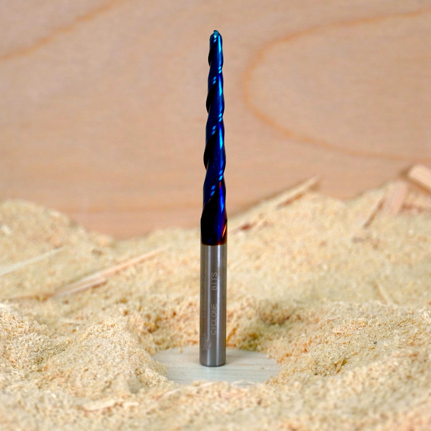

Built for detailed 3D carving, contouring, and finishing passes where strength and surface quality matter. The tapered profile adds rigidity over straight ball nose tools to reduce chatter and deflection, while the ball nose tip produces smooth contours. Nano Blue coating helps reduce heat and wear during long finishing passes.

Starting Parameters
Best used for finishing rather than heavy material removal.
  • Spindle: 18,000–24,000 RPM
  • Feed: 80–150 IPM
  • Plunge: 20–40 IPM
  • Cut Strategy: Use small stepovers and avoid aggressive plunges
