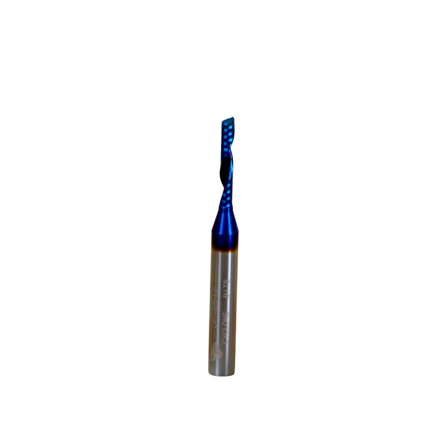

Built for clean, controlled cutting in plastics and other soft materials where chip evacuation and heat management matter most. The single-flute O-flute geometry clears chips efficiently to help reduce melting and improve edge quality, especially on smaller features and tighter geometry.
Best For
  • Acrylic
  • HDPE, UHMW, and Delrin
  • PVC
  • Thin plastic sheet goods
Why Choose It
  • Single flute for excellent chip evacuation
  • Helps reduce heat buildup in plastics
  • Ideal for small features and fine profiles
  • Produces clean edges with minimal melting
Starting Parameters
Higher RPM with controlled feed works best. Adjust for material, machine rigidity, and chip formation.
  • Spindle: 18,000–24,000 RPM
  • Feed: 80–180 IPM
  • Plunge: 20–40 IPM
  • Cut Strategy: Keep feed high enough to make chips, not dust
Specifications
  • Tool Type: O-Flute End Mill
  • Flutes: 1
  • Cutting Diameter: 1/8"
  • Cutting Length: 0.79"
  • Shank Diameter: 1/4"
  • Overall Length: 2.36"
  • Material: Tungsten Carbide
  • Coating: Nano Blue
Notes
  • Not recommended for hardwood or plywood
  • Avoid slow feeds in plastic to prevent melting
  • Air assist or vacuum extraction improves results
