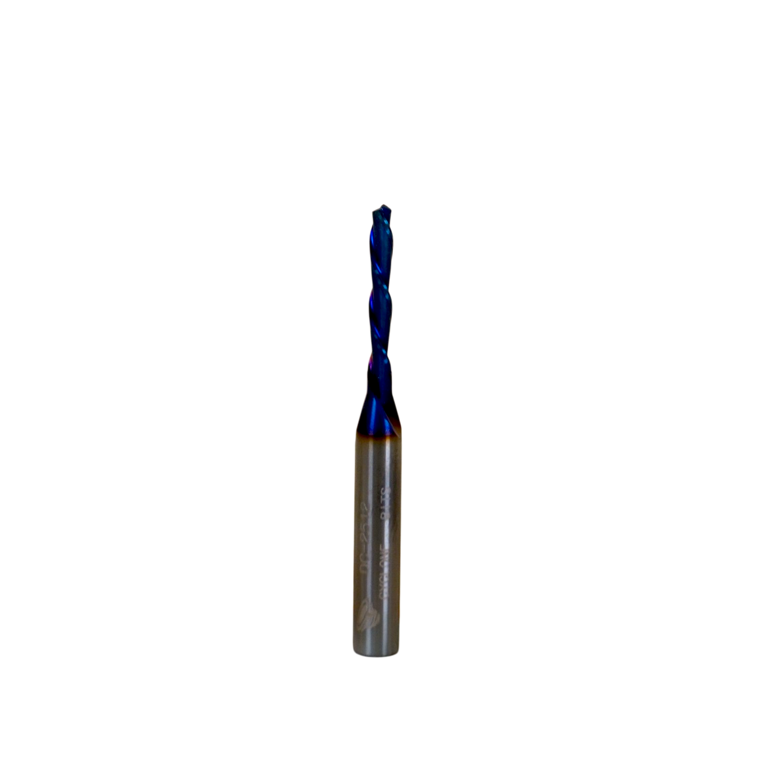

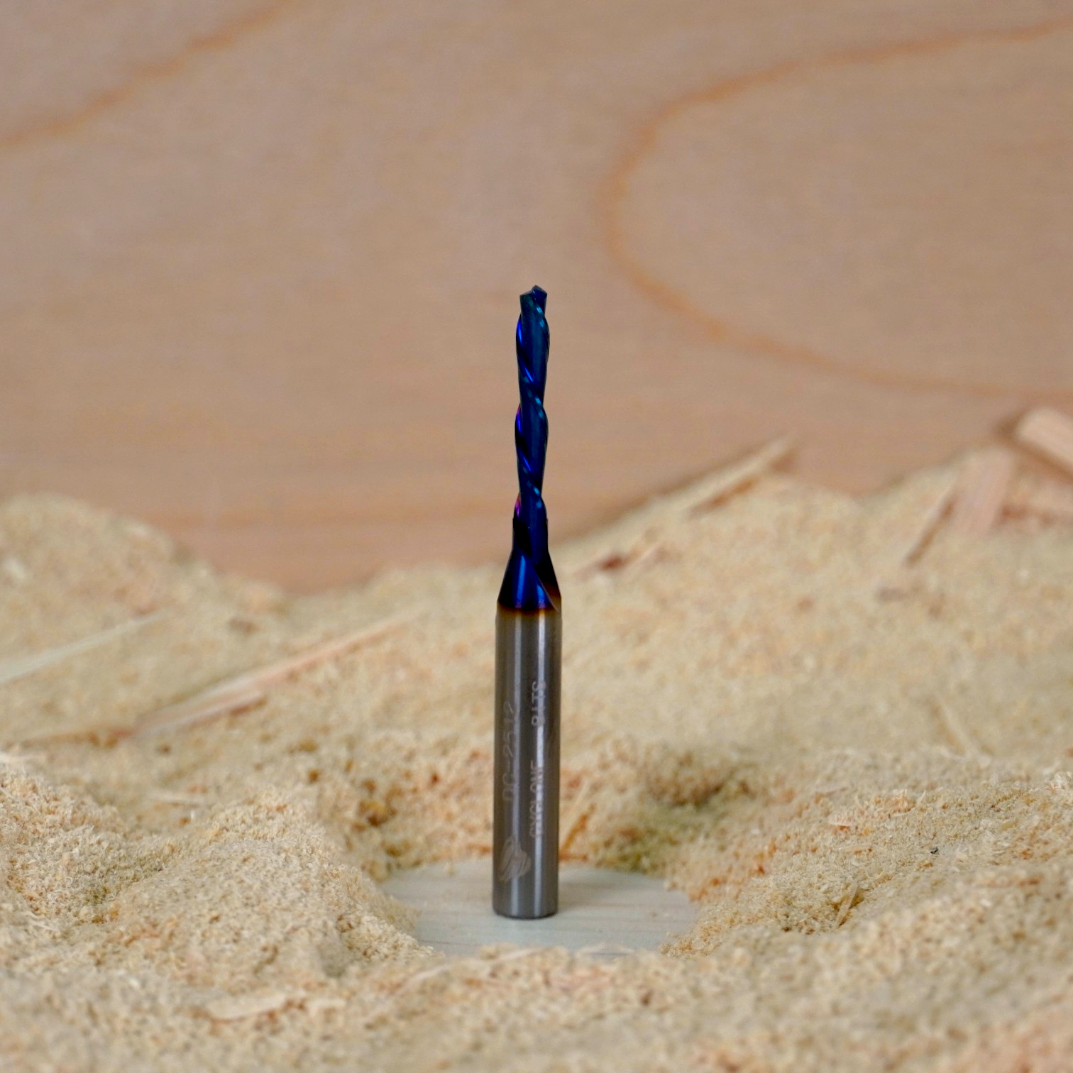

Built for clean top-edge finishes and fine detail work. The down-cut geometry pushes chips downward to help prevent top-surface tear-out, making it a great choice for visible parts, inlays, and precision profiling. Nano Blue coating improves heat resistance and tool life on spindle-driven CNC machines.

Starting Parameters
Small-diameter tools need higher RPM and lighter cuts for best results.
  • Spindle: 18,000–24,000 RPM
  • Feed: 80–150 IPM
  • Plunge: 25–50 IPM
  • Cut Strategy: Use conservative depths and clear chips often

  • Tool Type: Down-Cut End Mill
  • Flutes: 2
  • Cutting Diameter: 1/8"
  • Cutting Length: 0.87"
  • Shank Diameter: 1/4"
  • Overall Length: 2.36"
  • Material: Tungsten Carbide
  • Coating: Nano Blue
