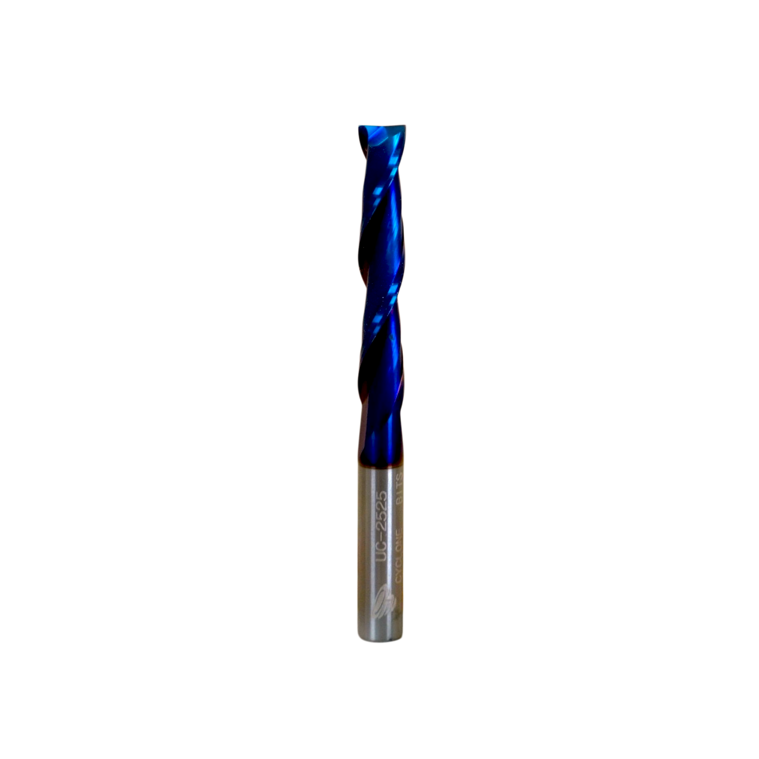

Built to pull chips up and out of the cut for efficient material removal and cooler cutting. This versatile 1/4" up-cut end mill is ideal for roughing, pocketing, and slotting, while the Nano Blue coating helps improve heat resistance and tool life on spindle-driven CNC machines.
Best For
  • Roughing
  • Pocketing
  • Slotting
  • General-purpose CNC cutting
Why Choose It
  • Strong chip evacuation for deeper cuts
  • Helps reduce heat buildup and tool wear
  • Forgiving on a wide range of CNC machines
  • Great for fast, efficient material removal
Starting Parameters
Up-cut tools support more aggressive cutting thanks to better chip evacuation.
  • Spindle: 16,000–22,000 RPM
  • Feed: 150–250 IPM
  • Plunge: 50–80 IPM
  • Cut Strategy: Adjust feed and depth for material hardness and machine rigidity
Compatible Materials
  • Hardwood
  • Softwood
  • MDF
  • Plastics
  • Aluminum with light passes and good chip clearing
Specifications
  • Tool Type: Up-Cut End Mill
  • Flutes: 2
  • Cutting Diameter: 1/4"
  • Cutting Length: 1.5"
  • Shank Diameter: 1/4"
  • Overall Length: 2.75"
  • Material: Tungsten Carbide
  • Coating: Nano Blue
Notes
  • May cause top-surface tear-out on plywood or veneers
  • Pair with a down-cut or compression bit when top finish matters
  • A strong general-purpose choice for many CNC operations
