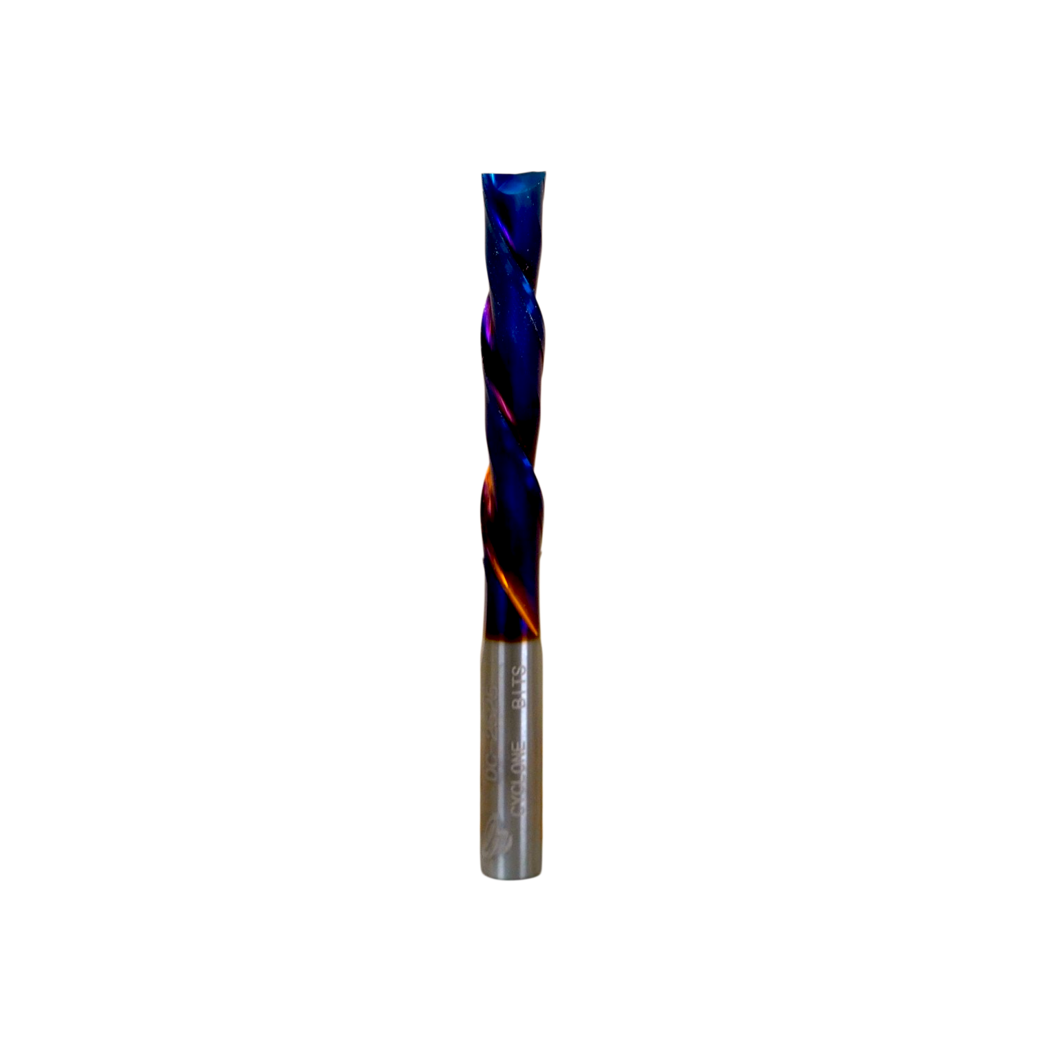

Built for clean top-edge finishes where surface quality matters more than chip evacuation. The down-cut geometry pushes chips into the cut to help minimize tear-out, making it a strong choice for visible edges, final passes, and veneered materials. Nano Blue coating improves heat resistance and tool life.
Best For
  • Clean top-edge finishes
  • Visible edges and final passes
  • Plywood and veneered materials
  • Laminated sheet goods
Why Choose It
  • Leaves a very clean top surface
  • Helps reduce tear-out
  • Great control on plywood and veneers
  • Ideal when finish matters most
Starting Parameters
Down-cut tools trap chips, so lighter passes work best.
  • Spindle: 16,000–20,000 RPM
  • Feed: 120–200 IPM
  • Plunge: 40–60 IPM
  • Cut Strategy: Use shallow passes and steady feed rates to avoid chip packing
Compatible Materials
  • Plywood and veneered plywood
  • MDF
  • Hardwood
  • Softwood
  • Laminated materials
Specifications
  • Tool Type: Down-Cut End Mill
  • Flutes: 2
  • Cutting Diameter: 1/4"
  • Cutting Length: 1.5"
  • Shank Diameter: 1/4"
  • Overall Length: 2.75"
  • Material: Tungsten Carbide
  • Coating: Nano Blue
Notes
  • Not ideal for deep pocketing due to chip evacuation limits
  • Use dust collection to reduce chip buildup
  • For through-cuts, pair with an up-cut or compression bit when needed
