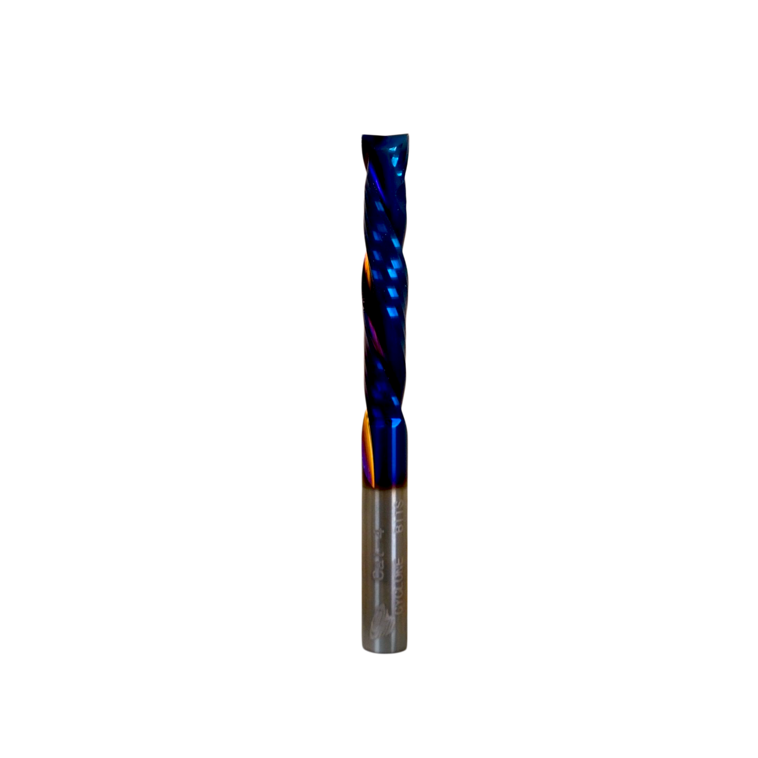

Built for clean, chip-free edges on both the top and bottom of sheet goods. The compression geometry combines up-cut and down-cut flutes to pull fibers inward and reduce tear-out, making it ideal for plywood, laminates, and veneered materials on spindle-driven CNC machines.
Best For
  • Plywood
  • MDF
  • Laminated sheet goods
  • Veneered panels
Why Choose It
  • Clean top and bottom edges in one pass
  • Great for sheet goods and laminates
  • Nano Blue coating reduces heat and friction
  • Stable cutting at higher spindle RPMs
Starting Parameters
Conservative starting values for spindle-driven CNC machines.
  • Spindle: 16,000–18,000 RPM
  • Feed: 120–180 IPM
  • Plunge: 40–60 IPM
  • Cut Strategy: Run deep enough to fully engage the compression zone
Specifications
  • Tool Type: Compression End Mill
  • Flutes: 2
  • Cutting Diameter: 1/4"
  • Cutting Length: 1.5"
  • Shank Diameter: 1/4"
  • Overall Length: 2.75"
  • Material: Tungsten Carbide
  • Coating: Nano Blue
Notes
  • Best performance comes at full or near-full material thickness
  • Shallow passes will not produce clean edges on both faces
  • Proper dust collection improves cut quality and tool life
