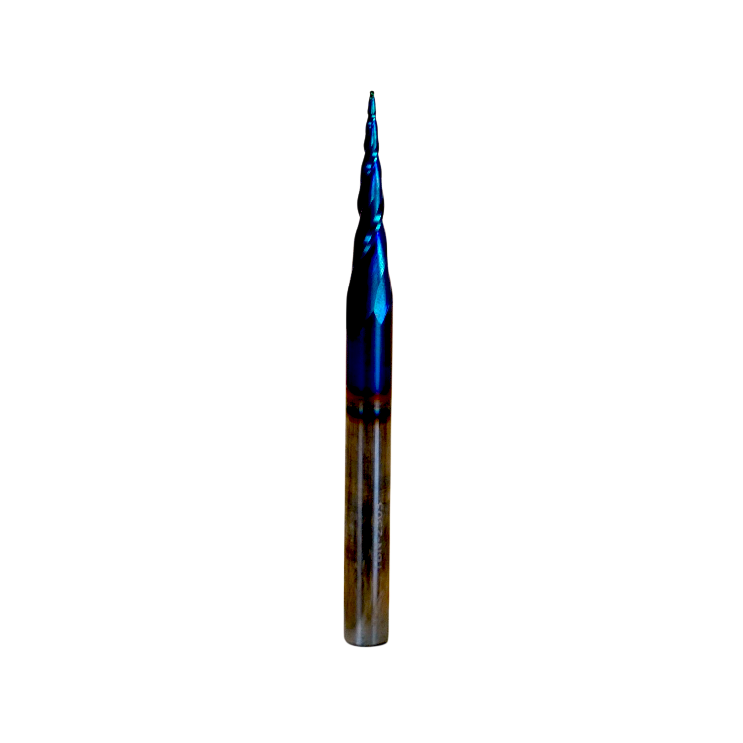

Overview
Built for ultra-fine detail work where precision and surface finish matter most. The tapered profile adds rigidity over straight 1/32" cutters for cleaner results, deeper reach, and reduced deflection. Nano Blue coating improves heat resistance and edge life at high spindle speeds.
Best For
  • High-detail 3D carving
  • Relief work and finishing passes
  • Fine lettering and textures
  • Detailed contouring and artwork
Why Choose It
  • More rigid than straight 1/32" tools
  • Reduces deflection at deeper reach
  • Produces cleaner 3D finishes
Starting Parameters
Conservative starting values. Adjust for material, machine rigidity, and finish goals.
  • Spindle: 18,000–24,000 RPM
  • Feed: 40–100 IPM
  • Plunge: 15–30 IPM
  • Stepdown: 0.01"–0.03"
  • Stepover: 5–10%
Compatible Materials
  • Hardwood and softwood
  • MDF
  • Plastics
  • Modeling board and foam
Specifications
  • Tool Type: Tapered Ball Nose
  • Tip Diameter: 1/32"
  • Flutes: 2
  • Overall Length: 3.15"
  • Cutting Length: 1.77"
  • Shank Diameter: 1/4"
  • Material: Tungsten Carbide
  • Coating: Nano Blue
Notes
  • Small tips require careful zeroing
  • Avoid aggressive plunges and heavy stepdowns
  • Best used for finishing, not roughing
