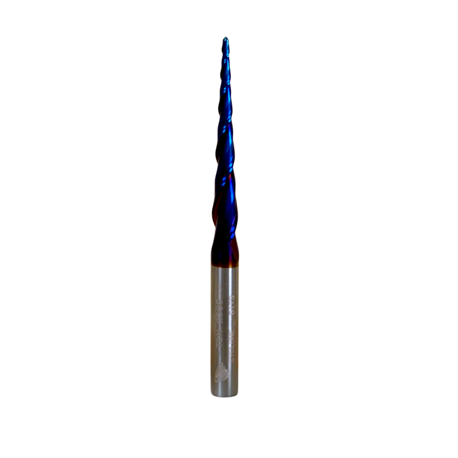

Overview
Built for ultra-fine detail work where precision and surface finish matter most. The tapered body adds rigidity over straight 1/16" cutters, allowing cleaner results, deeper reach, and reduced chatter during high-resolution 3D carving and finishing passes.
Best For
  • High-detail 3D reliefs
  • Fine contours and textures
  • Finishing passes
  • Detailed carving in wood and plastics
Why Choose It
  • Fine tip for detailed work
  • Tapered body improves rigidity and tool life
  • Reduces chatter vs. straight micro-tools
  • Ideal for long, light finishing passes
Starting Parameters
This is a finishing tool. Use light cuts and small stepovers for best results.
  • Spindle: 20,000–24,000 RPM
  • Feed: 50–120 IPM
  • Plunge: 15–30 IPM
  • Cut Strategy: Use very small stepovers for smooth finishes
Compatible Materials
  • Hardwood
  • Softwood
  • MDF
  • Plastics
Specifications
  • Tool Type: Tapered Ball Nose
  • Flutes: 2
  • Tip Diameter: 1/16"
  • Cutting Length: 1.77"
  • Shank Diameter: 1/4"
  • Overall Length: 3.15"
  • Material: Tungsten Carbide
  • Coating: Nano Blue
Notes
  • Designed for finishing, not roughing
  • Keep stepovers light to prevent overload
  • Consistent spindle RPM improves finish
