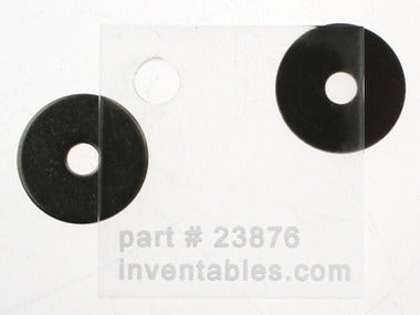

Acrylic is a plastic material that looks similar to glass, but is less brittle and provides better insulation. This acrylic sheet comes in both extruded, or “continuous cast” acrylic, as well as cast acrylic. Extruded acrylic is less expensive than cast acrylic, is softer, and can scratch easier. Here is a picture of what both cast and extruded bought from our store look like when laser etched.
