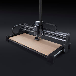

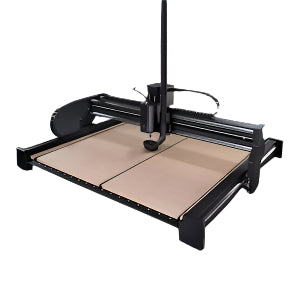

Size and Weight
4x4
Work Area (X Y Z):48in x 48in x 4in
Footprint:65.75in x 55.75in
Weight:300lbs (approx)
4x2
Work Area (X Y Z):48in x 24in x 4in
Footprint:65.75in x 31.6in
Weight:275lbs (approx)
Finish
Powder-coated aluminum
Spindle & Cooling
Spindle Power: 2hp (1.5kW)
VFD: Pre-Programmed
Cooling: Air cooled
RPM: From 1.5 kW spindle at 8000 - 24000 RPM
Collet: ER16-A with ⅛" and ¼" collets included. (Up to 3/8" collet, purchased separately)
Accuracy: .001in
Gantry
Drive System: High-precision 1" ball screws with linear guides
Motors: NEMA-23 with 292 oz-in
Gantry Clearance: 5in
Z-Axis Max Travel: 6.5in
Dust Control
Includes:Dust shoe, hose, arm
Connects To:Most standard vacuum systems
Control
Connectivity:USB
Controller:Encased to minimize dust exposure; separate machine interface with Pause, Resume, and Reset button controls, Z-Probe connection point, and E-Stop capabilities
Power
120VAC +/-10% @ 60Hz +/-5%
Not compatible with GFI/GFCI outlets and breakers
Easel Pro Software
Easel Pro
Options: 1 or 3 year subscriptions (select option as an add-on)
Tiling:Seamlessly carve larger than the carvable area
Graphics Library:5 million+ royalty-free graphics
Software Compatible
Easel can import SVG, DXF, and .gcode files from other software such as Fusion360, SolidWorks, AutoCad, VCarve Pro, Aspire, Photoshop, InDesign, and Illustrator
Carvable Materials*
Wood/Wood Composites:Hardwoods, softwoods, MDF, plywoods, etc.
Plastics:HDPE, Delrin®️, polycarbonate, acrylic, Corian®️, etc.
Non-Ferrous Metals**:Aluminum, brass, copper, etc.
Import File Types:G-Code, SVG, or DXF files from any software
What's in the box
- X-Carve Pro
- Controller and cables
- Separate HMI controller with Pause, Resume, and Reset button controls, Z-Probe connection point and E-Stop
- Dust control system - Dust shoe, Hose, Arm
- Z-probe
- Cutting bit included: Planing bit
- T-slot wasteboard with threaded inserts - (4x4 model)
- T-slot clamps (x4) - (4x4 model only)
- Standard Threaded Insert Wasteboard Kit (4x2 model)
- Assembly tools (8) - 4ft level, Allen key set (1.5mm to 6mm), Torque wrench, Metric hex bit set, Metric socket set, 17mm wrench, Square
