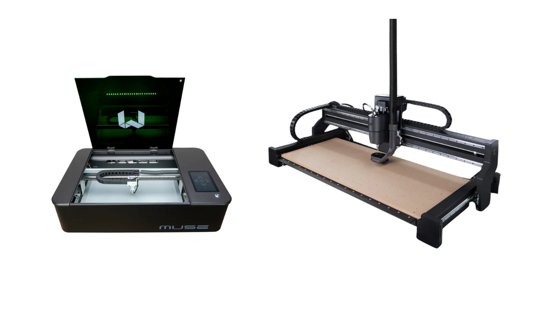

When it comes to digital fabrication, laser cutting & engraving with machines like Muse Series Laser Cutters and CNC milling with machines like the X-Carve Pro are two of the most powerful tools available. While they may seem like competing technologies, they are, in fact, complementary—each excelling in different applications and materials. Understanding when to use each can help you optimize your workflow and expand your creative and manufacturing capabilities.

Laser vs. CNC: Which One Should You Choose?
The choice between laser cutting and CNC milling depends on your project’s material, design complexity, and functional requirements.
| Feature | Laser Cutting & Engraving | CNC Milling |
| Best For | Intricate designs, branding, signage, and cutting thin materials | Functional parts, deep cuts, and 3D machining |
| Materials | Wood, acrylic, leather, fabric, coated metals | Wood, metals, plastics, composites |
| Cutting Depth | Typically shallow, up to 1/2" in softer materials | Can cut several inches deep depending on the tool |
| Speed | Fast for engraving and thin cuts | Capable of longer, complex, deep cuts |
| Edge Finish | Burnished/smooth edges depending on material | Sharp edges, may require sanding |
| Production Scale | Ideal for customization and one-off designs, inefficient for production runs | Better for batch production of durable parts |
