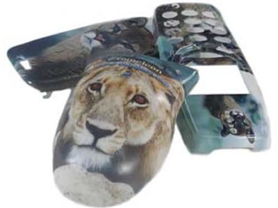

Nokia 6101/6102 faceplates
Applications for One-Off, 3D Decoration
Existing Use
Existing Use
Souvenirs

In-mold decoration is great for producing detailed decorations on complex surfaces, but what if you want each decorated part to be unique?
This process makes it possible to decorate almost any plastic or metal part with a unique image. An image is printed on standard ink jet printer using dye sublimation ink and a special film. The part you want to decorate is placed into an image box and the film is clamped into a frame over the part. A vacuum is used to pull the image tight onto the part, heat is applied, and the ink transfers from the film into the surface of the part in minutes.
This process will work with any plastic that will withstand the 250°F (125°C) required by the process. Some plastics and most metals require a primer coat to properly absorb the dye. Also, the process exerts significant pressure on the part, so a rubber molded nest is often used to support plastic parts. The parts can be done one at a time, or, on a larger machine, up to 40 at once. Applications for this process include:
● Decoration of one-off prototypes such as rapid prototyping parts (e.g. SLA) or silicone molded samples
● Use for mass customization, allowing consumers to create custom cell phone covers
● Create personalized tourist or gift items with images provided by the consumer
● Put the face of a child onto their own doll
