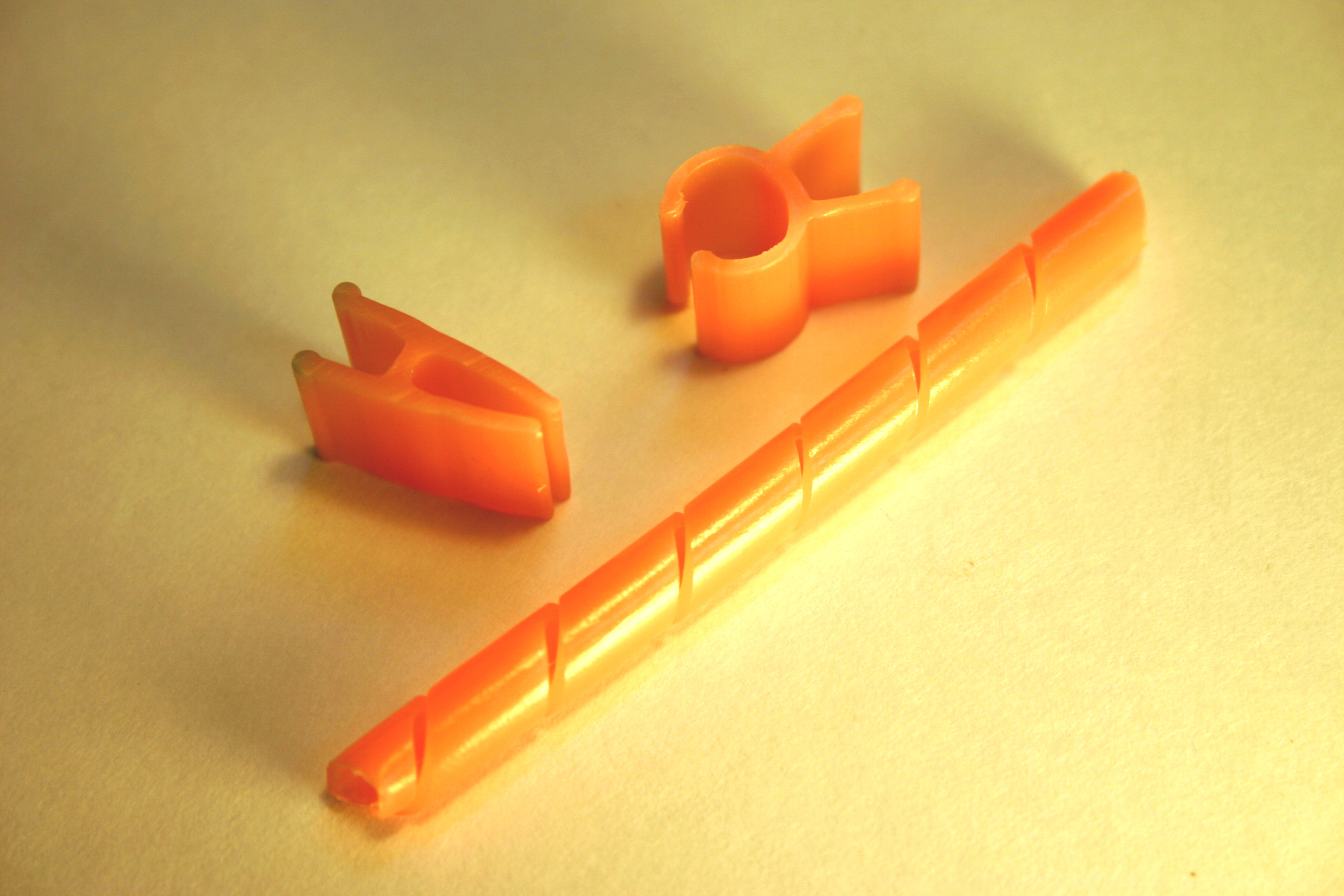

Heat-Sensing Plastic
Color-changing electrical safety insulation and retro-fiting cable clips, spiral wraps and cable ties for cord sets.

Can be clipped or wrapped onto any existing cord sets

It is normally impossible to know the temperature of an object without touching it, which makes thermochromic materials fascinating because they make visible what is normally invisible. The colorful electrical plugs and wiring in the picture (on the photo of the sample) make clever use of thermochromic technology – excessive, possibly dangerous, heat is marked by a change of color in the plug casing and cable jacket. The process is reversible, so the color reverts to the original hue once the equipment cools down. In addition to heat, the technology can also provide other sensory signals of over-heating wiring such as a foul smell or deformation.
Color-changing electrical equipment is useful in every industry where heavy use of plug and cord sets creates the potential for a significant fire hazard, or down-time. Thermochromic materials have many other applications. Existing uses include battery-testing labels, heat sensing for microwaveable foods, and temperature sensors for chilled beverages. And virtually any reversible color combination (cold and hot) can be ordered along with trigger temperatures from 10F to 170F and in most low temperature polymers. Also consider an irreversible color change to notify manufacturers of warranty voids or where visual inspections occur periodically.
